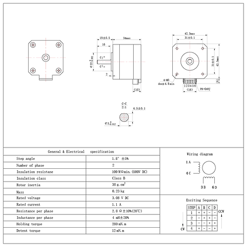

Can you send me the specifications of the engine that I should use? and the end of course too
