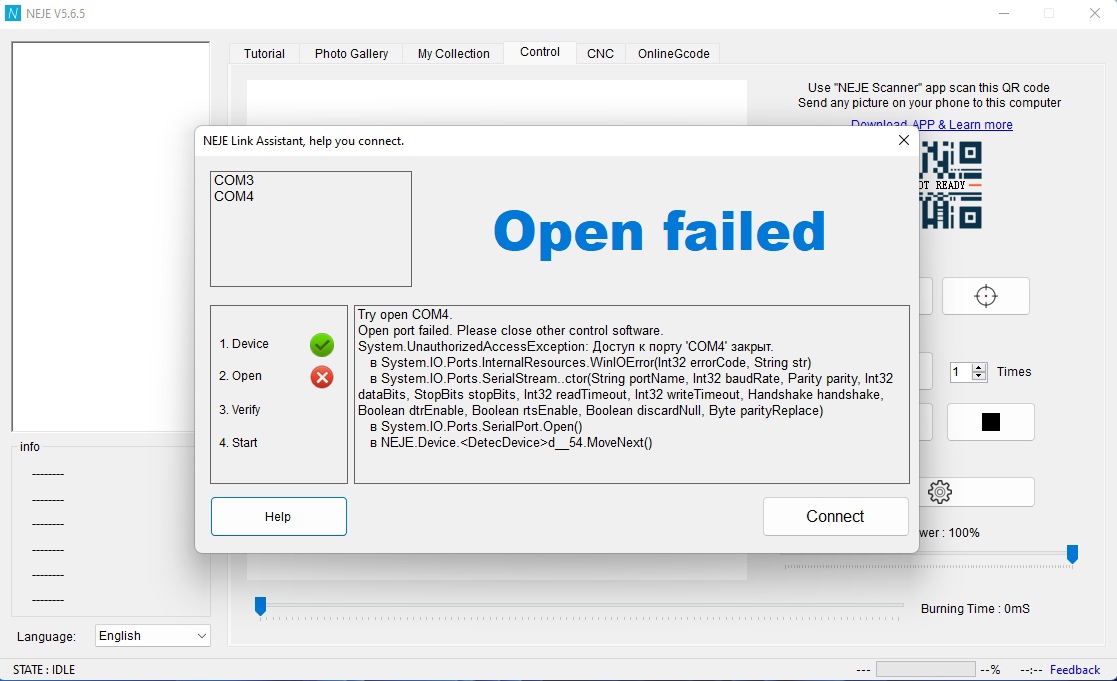

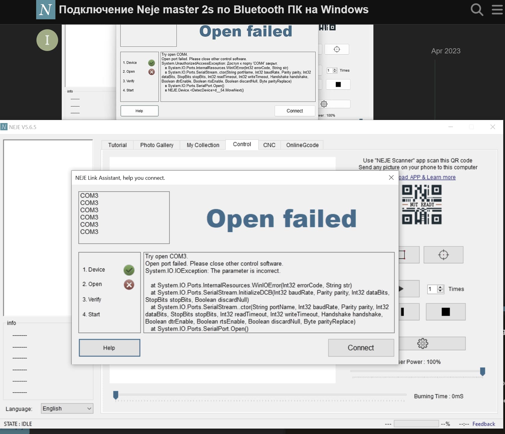

Hey @Jim , @JackWong I searched everywhere for a detailed instruction on how to connect Neje 2S Max via bluetooth to Windows 10 PC. Could you please provide detailed instructions? The device is discoverable when I search for available bluetooth devices but it would not pair. In Neje software the following error message appears:
With USB everything works fine.
Would much appreciate your help and wish you and your team great business on Monday 11.11)

Do you have other control software open?
Sorry, NEJE 2S series devices do not support connecting to a computer via Bluetooth.
Hey @Jim Many thanks for getting back to me this fast on Sunday! No, I don’t have any other control software open. Also I should notice that Stage 3 in the troubleshooting guide that you linked to in your reply doesn’t mention any issues with setting up bluetooth on Windows, it does address only Android problems. Blue LED on the device is ON when I am connecting to discovered bluetooth device in Windows yet it could not pair. Any other tips would be much appreciated.
