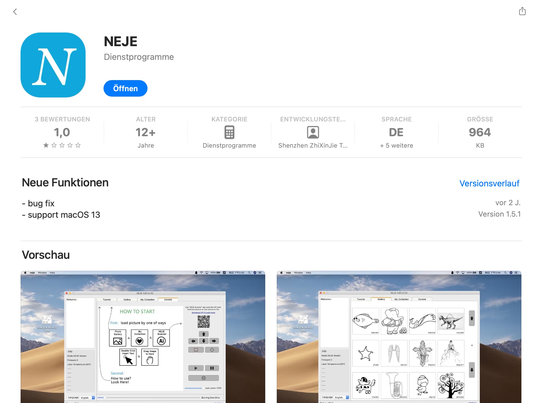

In the other link you’ve shared, we couldn’t find the model we have; namely, the NEJE Master 20w is not in the document. We’ve downloaded NEJE app as it’s the oldest version.

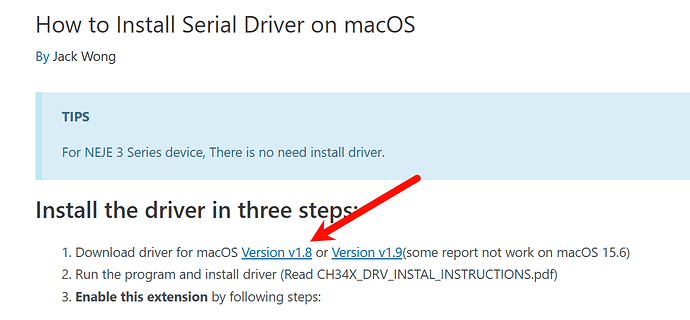

Make sure you have the v1.9 version of the driver installed

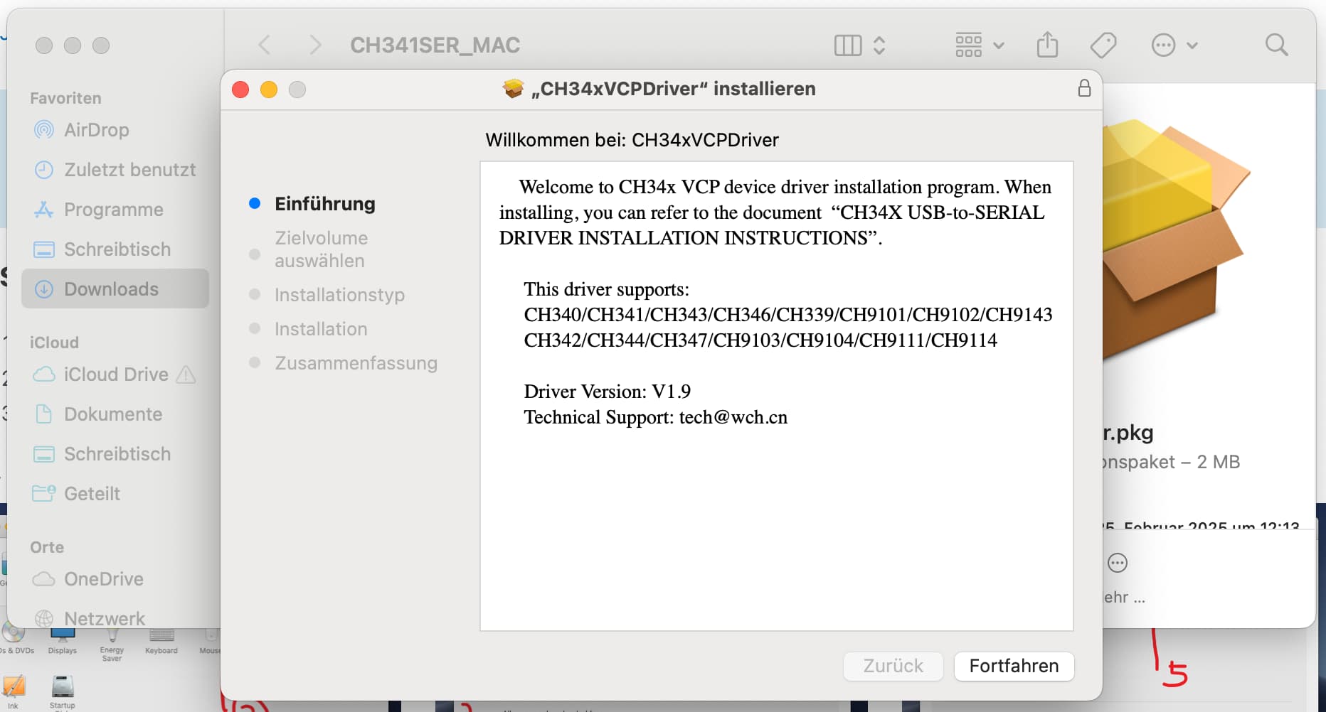

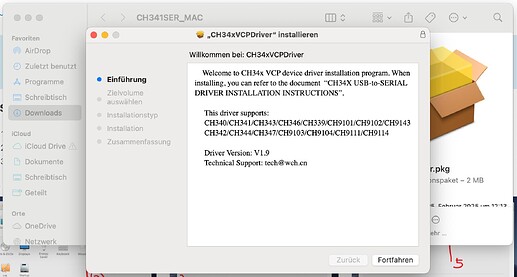

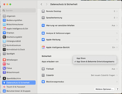

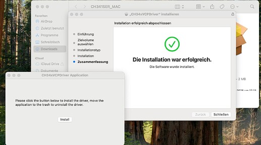

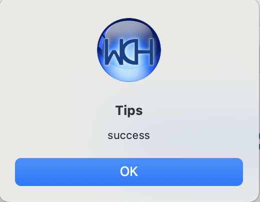

We’ve uninstalled everything and redid it again, but nothing changed. Here are some screenshots we took along the way.
We completely followed the pdf description (CH34X_DRV_INSTAL_INSTRUCTIONS.pdf) and have the driver installed, which was shown as successfully done.
As described in the document, the extension was enabled too.

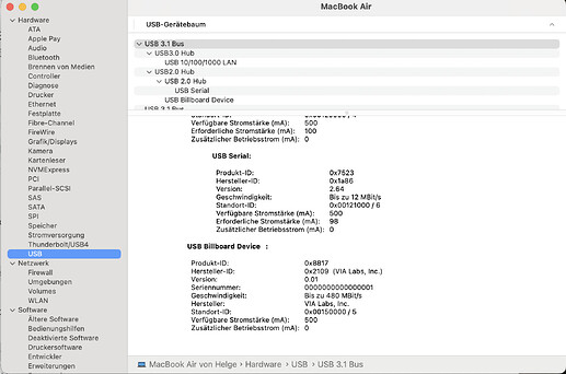

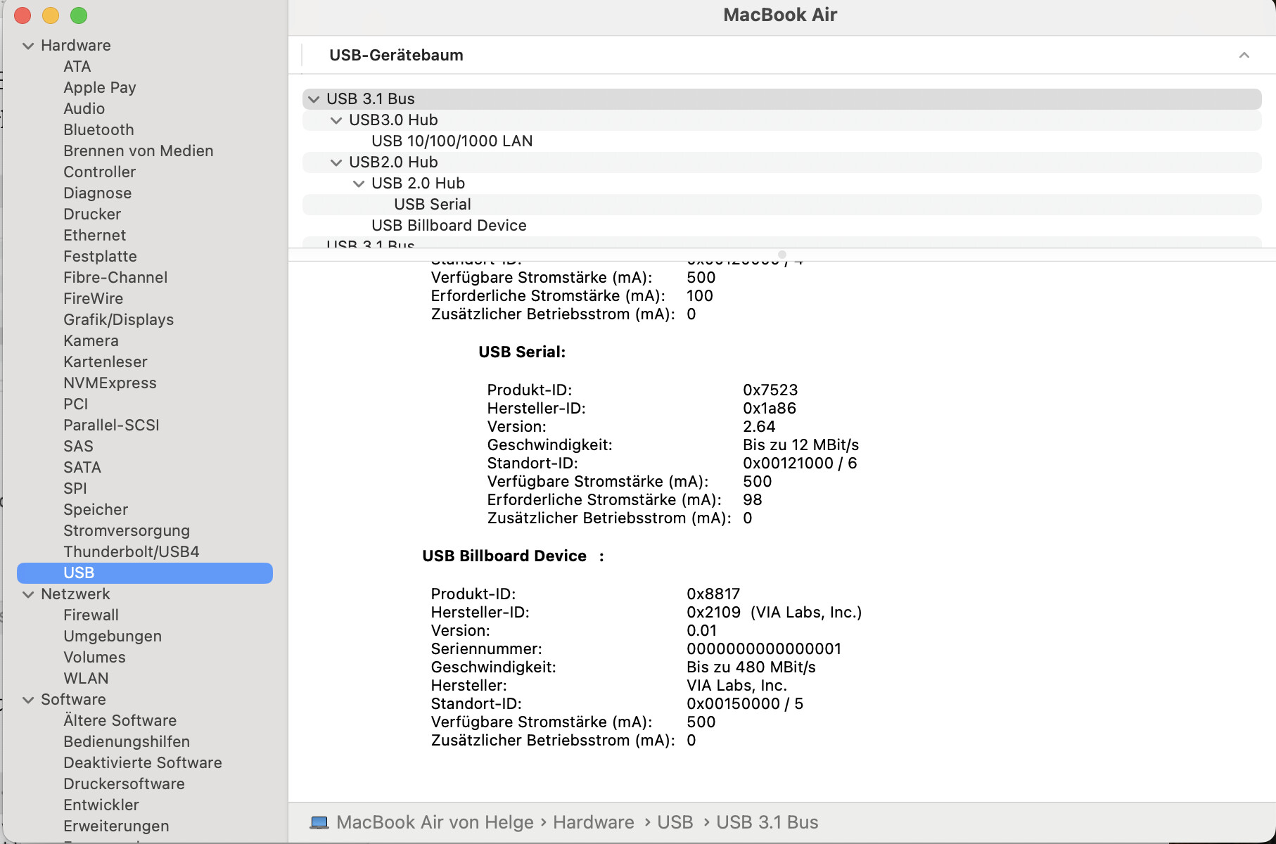

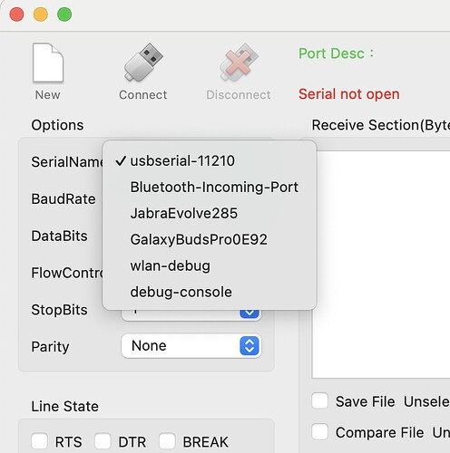

The USB connection works.

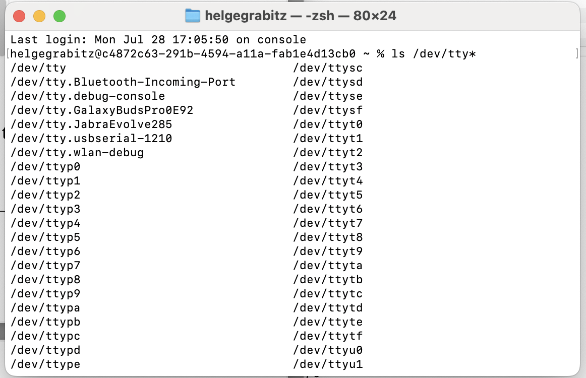

However we don’t see anything containing “tty.wchusbserial” through the terminal.

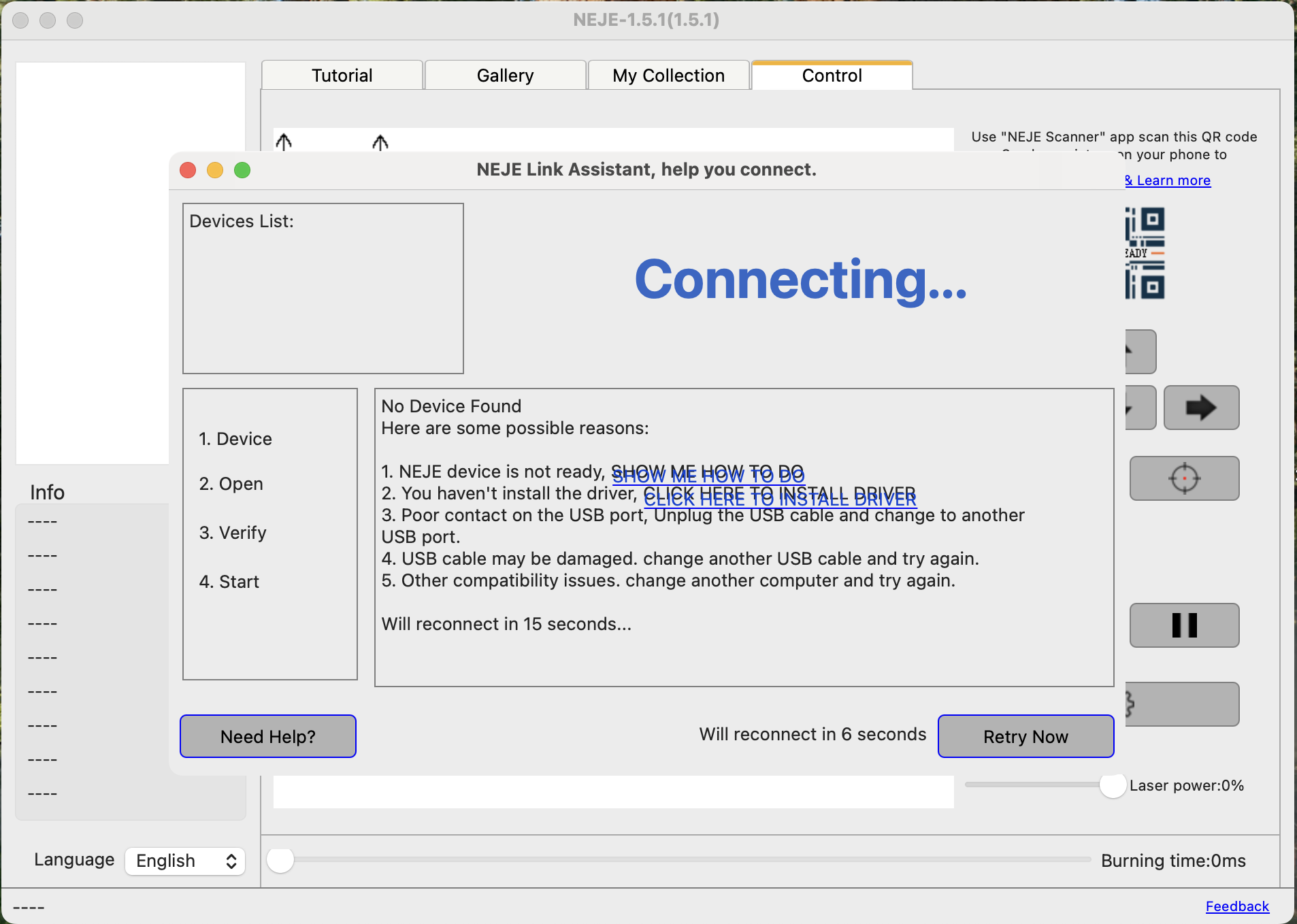

We’ve downloaded this NEJE app but it keeps showing No Device Found.
We restarted the MacBook whenever was required and again at the end, but still no connection, unfortunately. In the installation guide, it’s written that the driver was updated to support macOS 13, but we are using macOS 15.5, can you please verify whether the driver is compatible with our version? We hope that these screenshots can help to pinpoint the issue here.

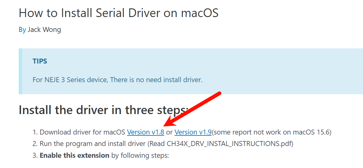

Indeed, v1.9 does not work.
But surprisingly, v1.8 works.
Please download the v1.8 version here
