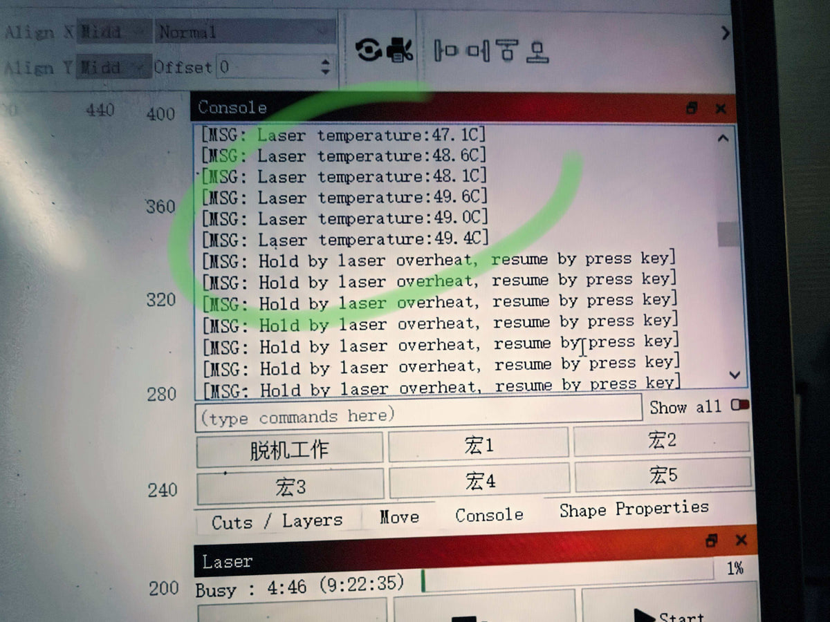

Please note that new NEJE mainboards with updated firmware​ now feature enhanced thermal protection. The system communicates directly with LightBurn—if the module overheats due to oil contamination, poor heat dissipation, or other factors, the firmware will trigger an automatic pause to prevent further damage.

The E80 features real-time temperature feedback—a standard in all NEJE laser modules. The recent updates primarily involve the motion control board firmware. You can simply open the NEJE software and upgrade to the latest version to access these improvements. For more details on how the LightBurn thermal linkage works, please refer to the NEJE Blog section, which has a dedicated explanation.
