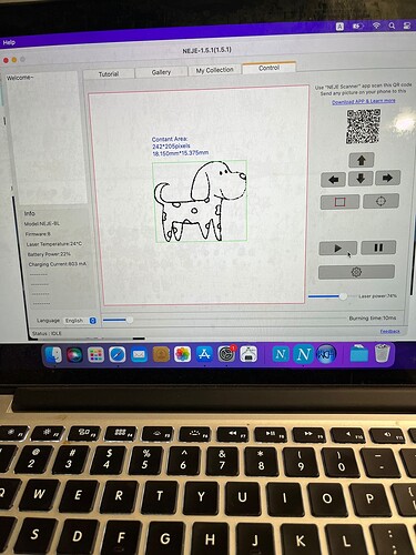

When sending the image to engraver, the laser makes the square, shows the area. But then stops, and app says status AT CARVING. But nothing happens.
So this doesn’t work.

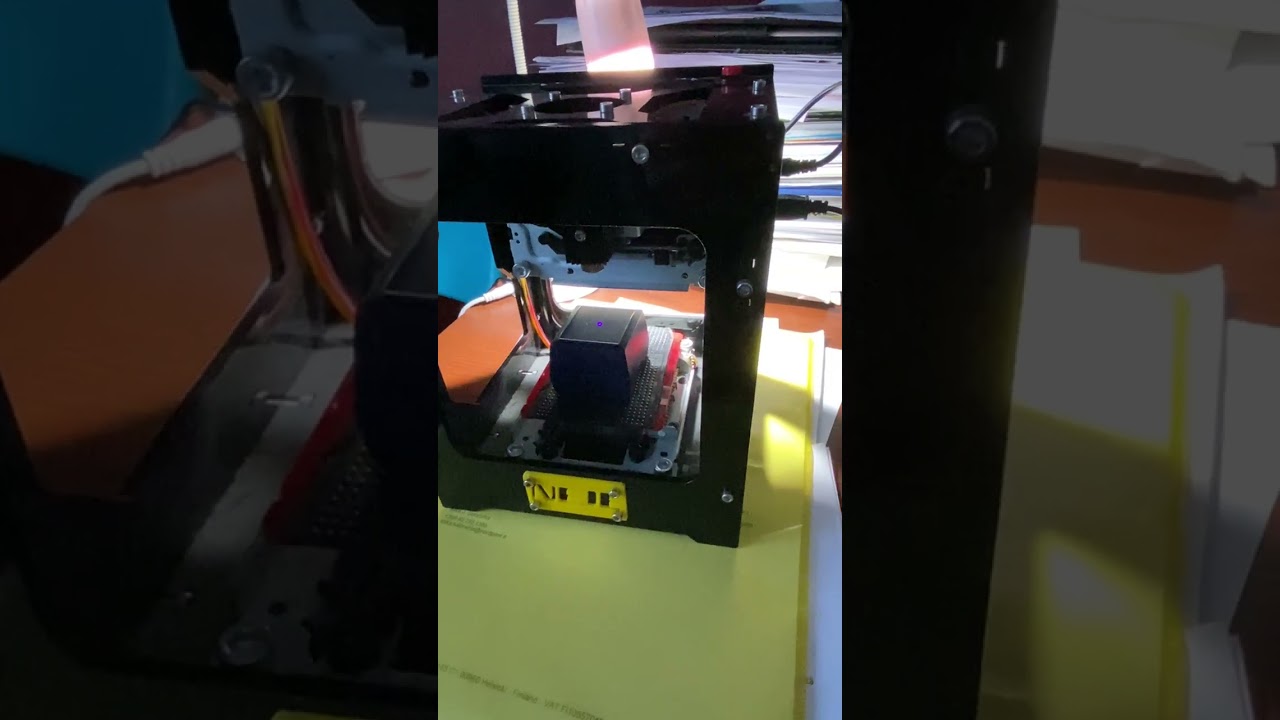

As you can see here on the video, when I send to engraver it does the square, and then stops. Nothing more happens.
And yes, it is updated to 1.5.1

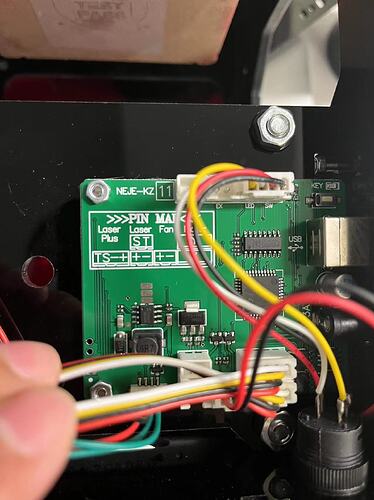

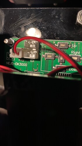

I watched your video, when did you buy the machine, can you take a picture of the version information of the main board of the machine?
Here is a picture:
Did you see this picture? Can you tell me what is wrong when the application doesn’t work yet?
We don’t have a prototype of your version. It’s been a long time. I can’t reproduce your fault. I can use the new KZ machine normally. Can you test it with another computer?
