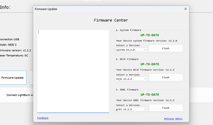

Firmware version: 2.2.2
Neje 3 application version: 6.6.8
Windows operating system.

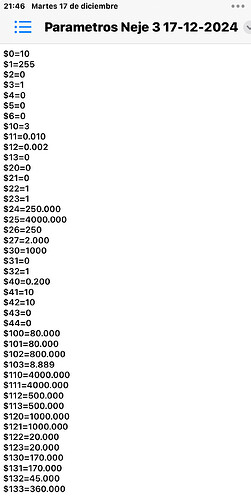

This is my list of parameters with firmware V2.2.2
What parameters do I have to change so that when I connect the Neje the Z axis goes home?
What command do I have to give with ($) so that it is memorized?
Or how do I proceed?
