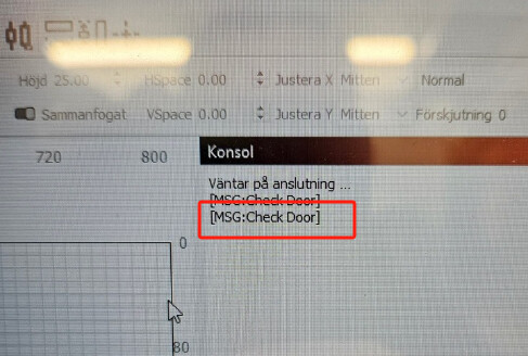

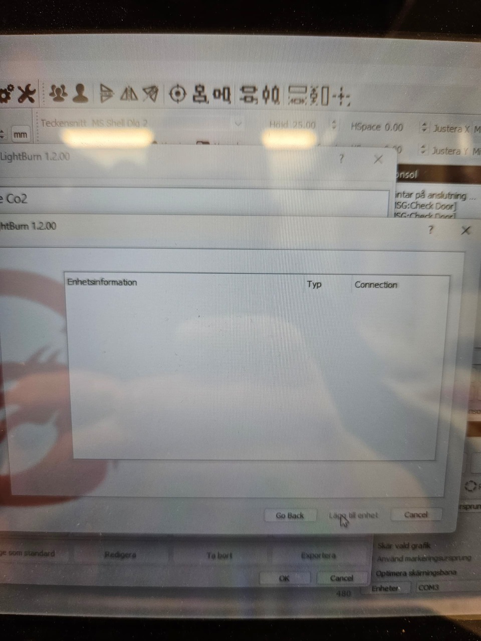

Hello. I have used my neje for some time now. No problem. But after i renewed my lightburn licens it wont connect. Have tried to reistall different drives and software/firmware from nejes site. Still nothing. I attach some photos of the issue.
How do i do that?

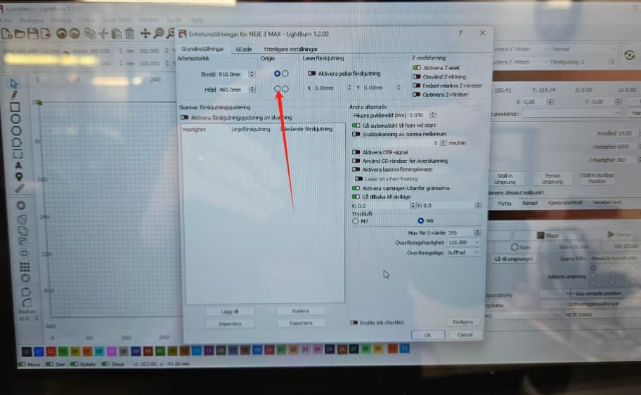

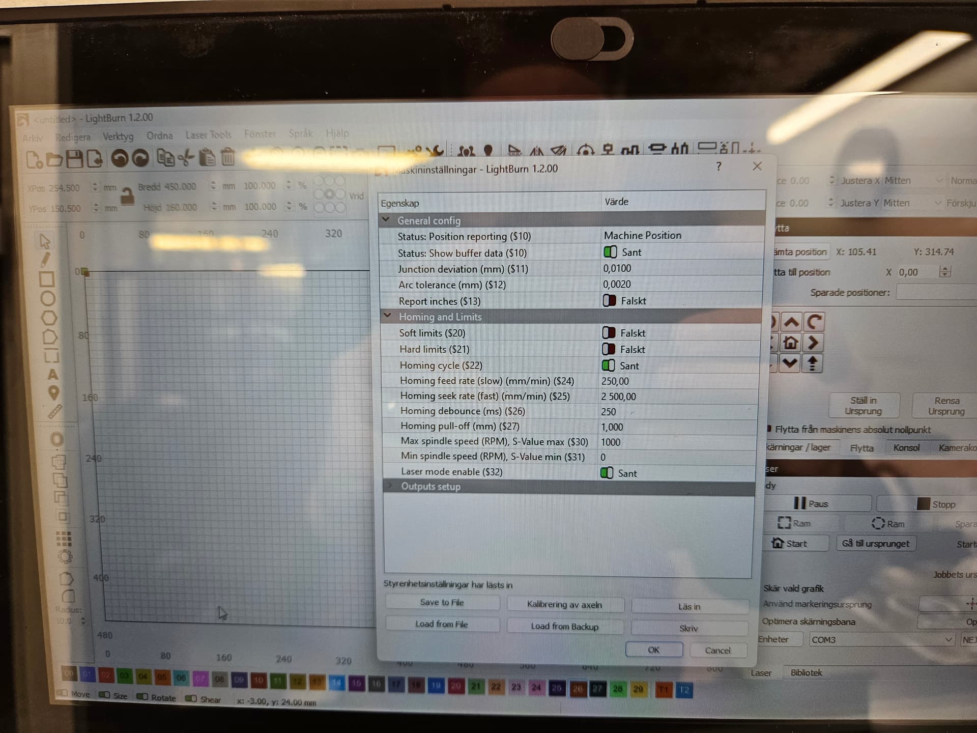

That worked. But now everything is upside down and mirrored. What is going on? I have checked the origin and it is where it should. I attach some photos of the screen. Do you se anything wrong?
The origin setting is wrong. The origin should be the front left and the homing position is the rear left. Please refer to the link and reset it.
https://neje99.com/faq/how-to-work-with-lightburn.html
