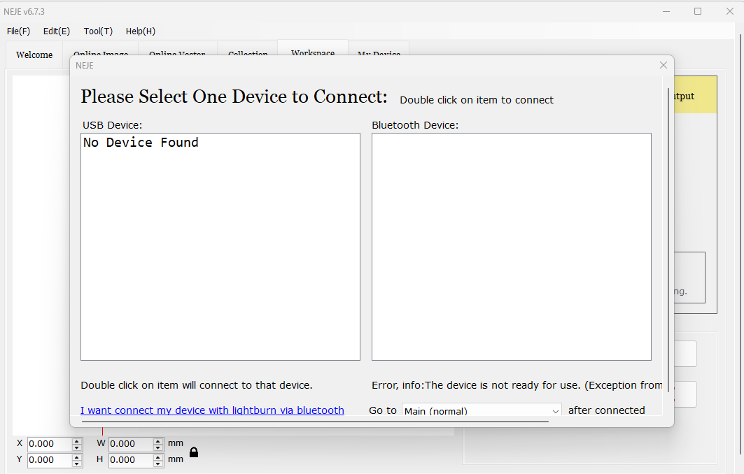

need help neje 2w dk-8-kz

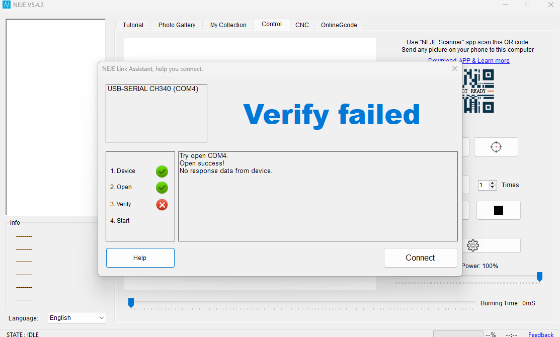

I have the correct software installed on windows 10, however the device will not verify connection.

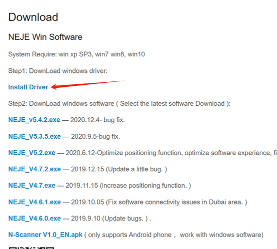

Is there a download driver?

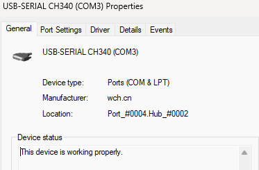

The driver is installed but my device is still not being found.

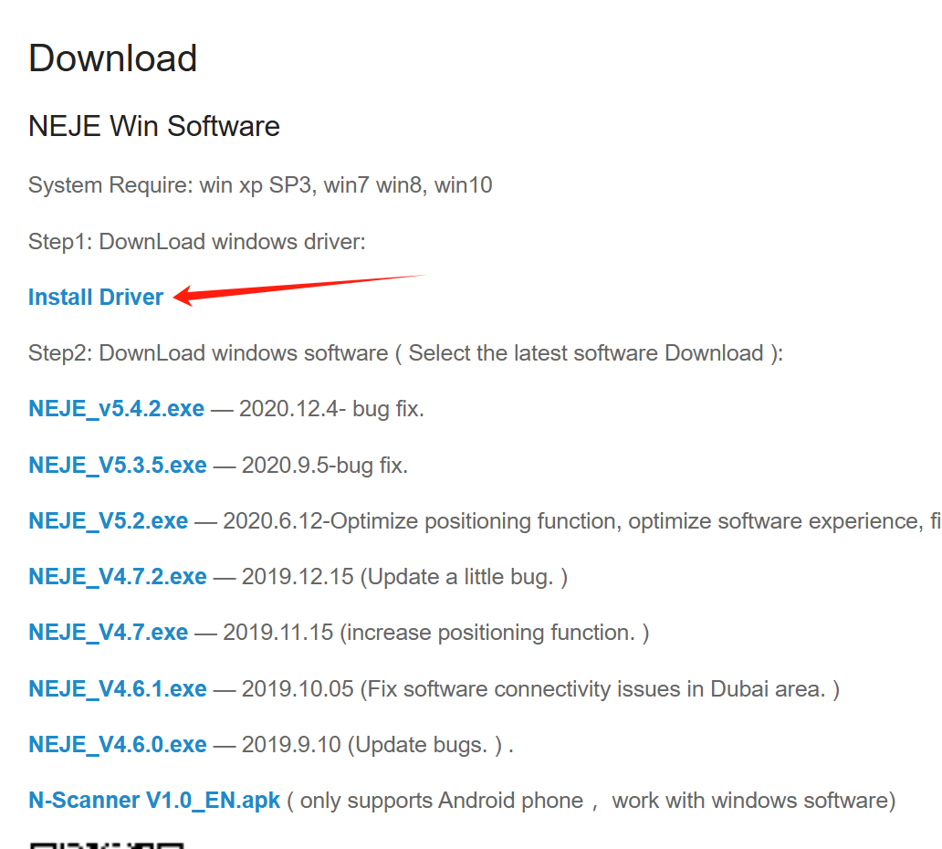

The software version you downloaded is too high. Please try the version in the screenshot.
I have the driver installed, i have the newest neje software. Device is powered on and usb connect to my windows 10 pc.

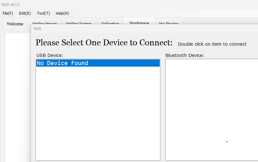

The software you downloaded is version V6.7.3, which is not suitable for KZ model machines. You can download other versions of software from this link

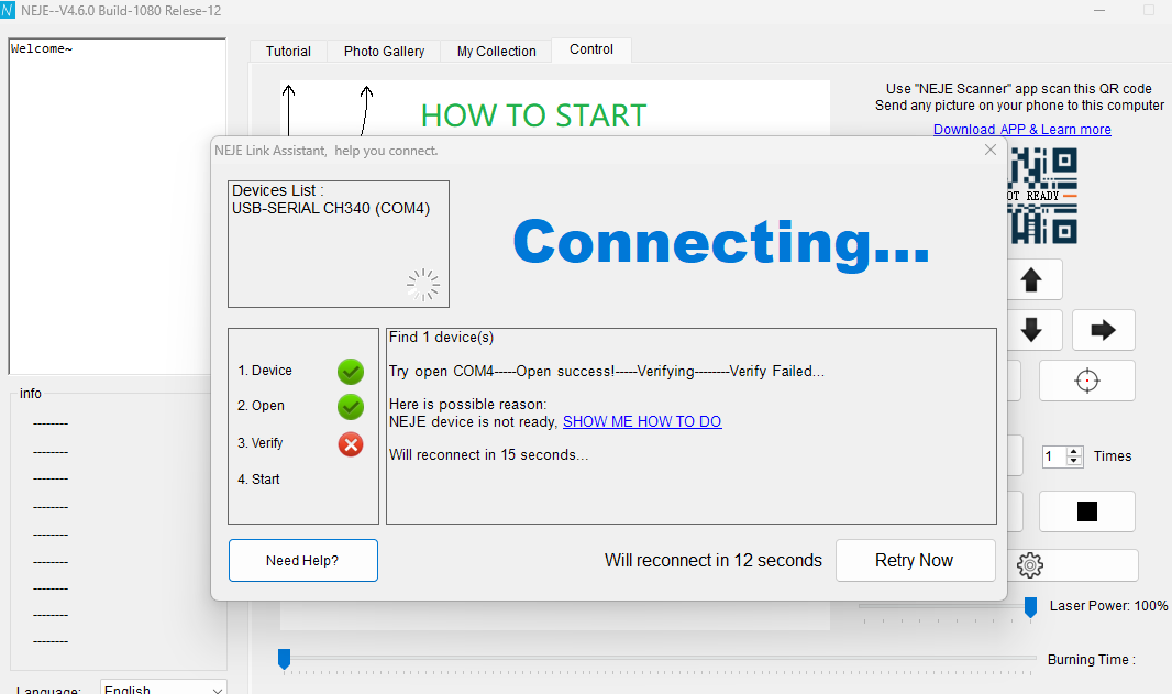

still not working with older softwware
Try a lower version
i tried every single one with the same result
If it still cannot start, there may be a problem with the machine’s motherboard
can you fix it?
This model has been discontinued for many years and we no longer have replacement parts
