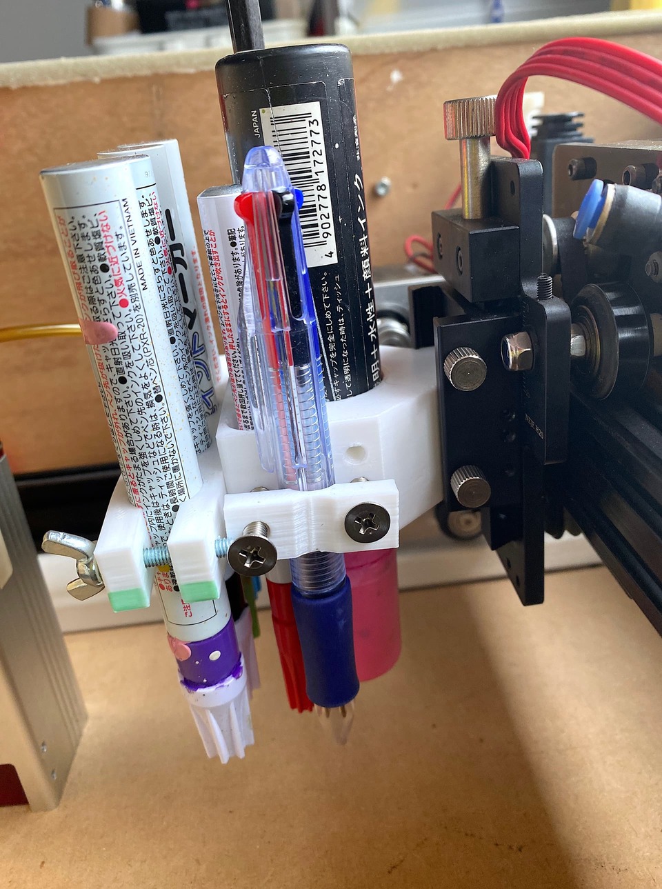

multi holder pen protoype for new max 4 drawing pen

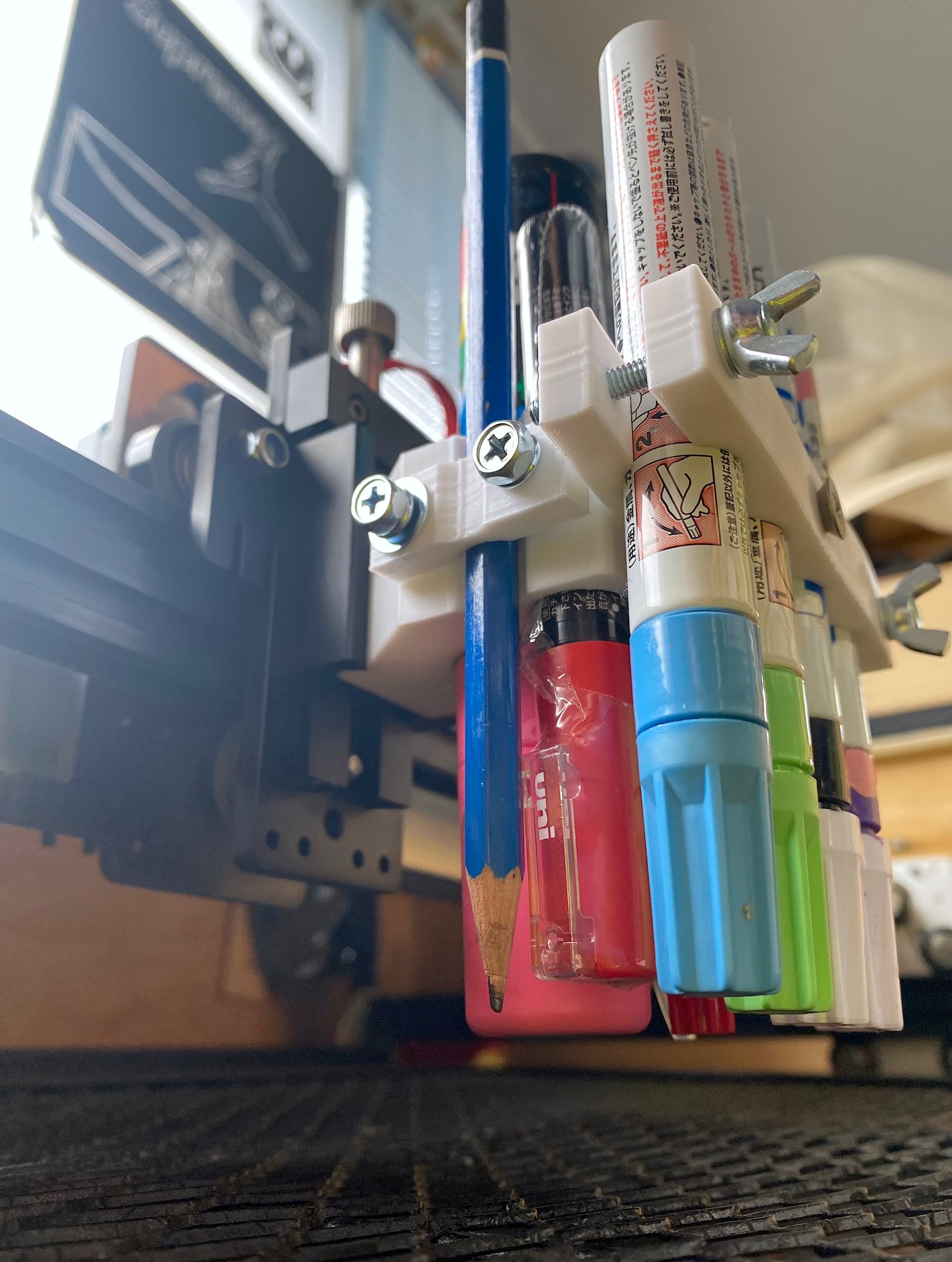

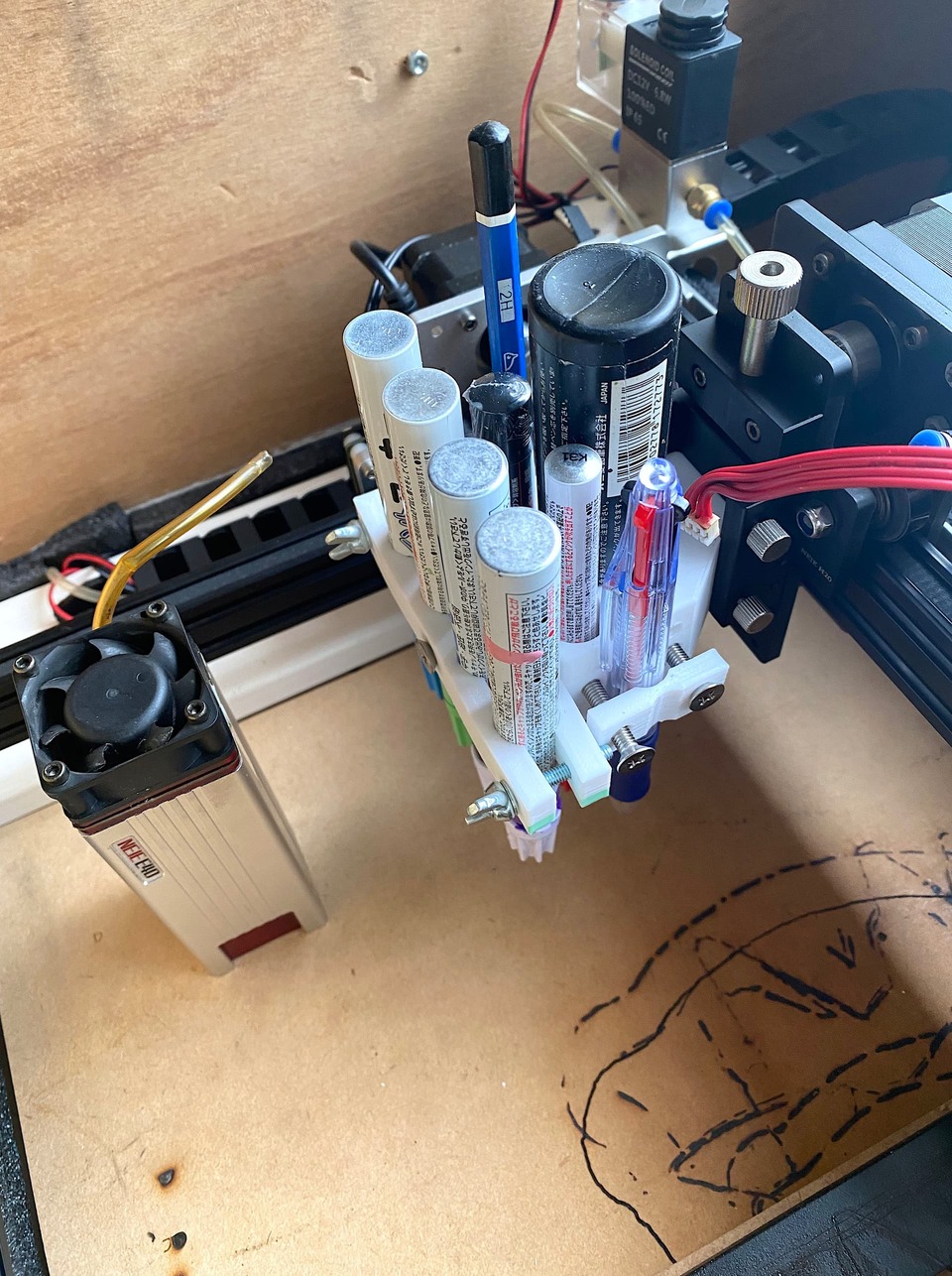

here is some idea for a multi pen holder. Can be set to different height, many size pen included large one. On the picture is setup with neje H20 holder but will be the same for the max 4 holder laser module and pen. New neje max 4 holder can hold 1 kg, E80 module is 680grs so no problem with those light pen!
As a artist I was waiting for a drawing pen from neje for 2 years, now it s done. Let s improve and enjoy it!
