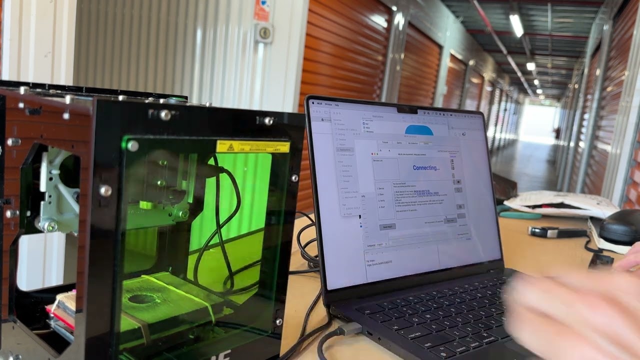

Laser module will not connect to software
New MacBook Pro 14" macOS 14.2.1

It’s a new USB. We had issues with the USB supplied by NEJE and swapped it. We haven’t had any issues on other computers.
USB’s taken out of machine, turned off and on, changed ports. Same issues.
Same issues. Works on old computer.

I know there’s nothing wrong with the laser. I said it was a software compatibility issue with new MacBook Pro 14” iOS Sonoma 14.2.1. Please read my previous notes.

Same problem. Laser will not connect.

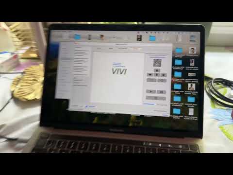

Hi, any news about it?? I’m having the same problem!!
Nothing. No response or solution has been provided. I cannot use it with my new Mac.
