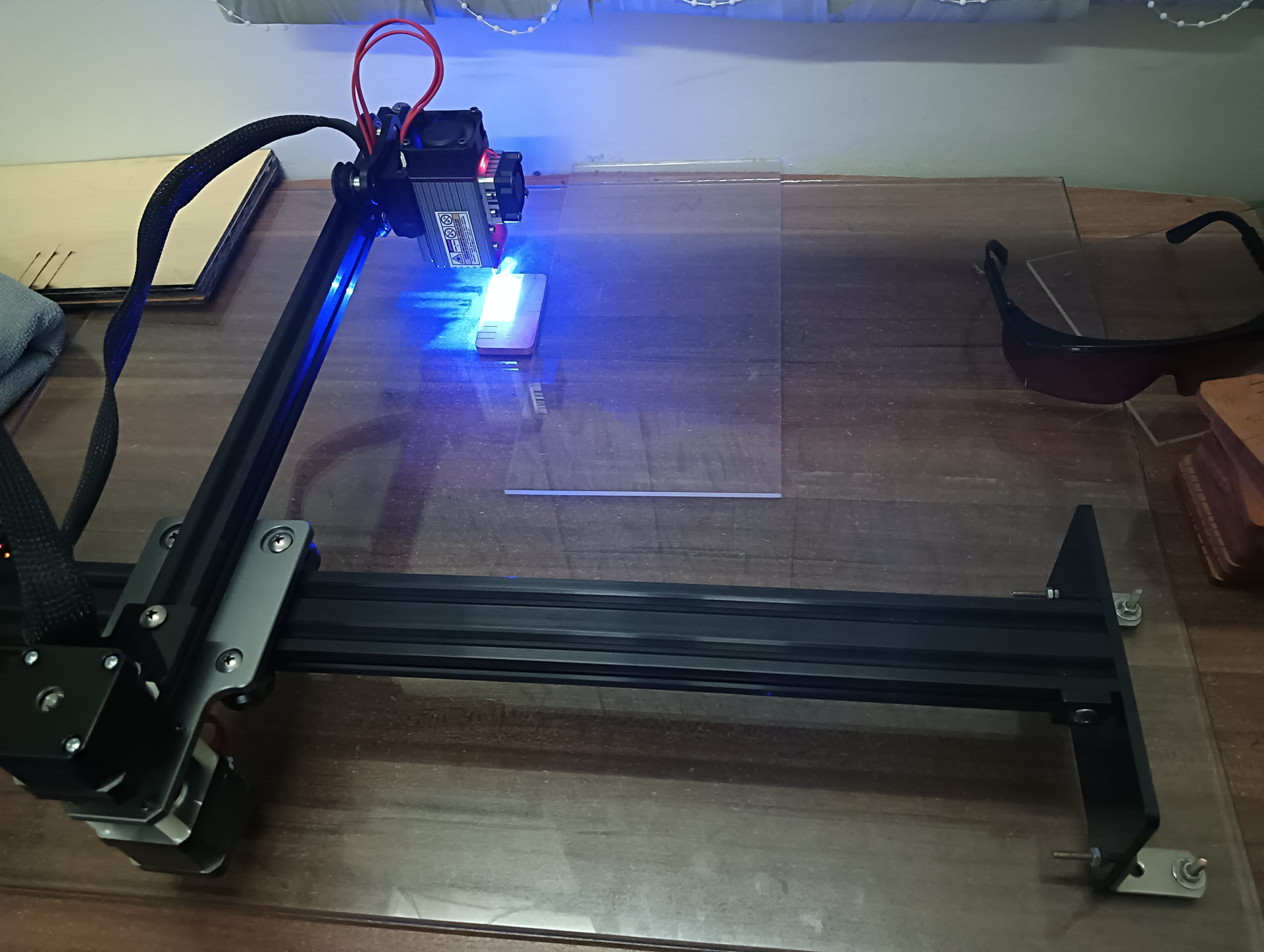

Increase avg power from 5.5 w to 15 w or more
This is my existing NEJE 5 - V 3.00 machine.
Which have avg power of 5.5 & peak power is 7.5 w only.
Is there have any system to integrate such that i can increase power to above 15 w?
If available kindly let me know.
I need to purchase it for my existing machine.
Expecting quick response from the authority

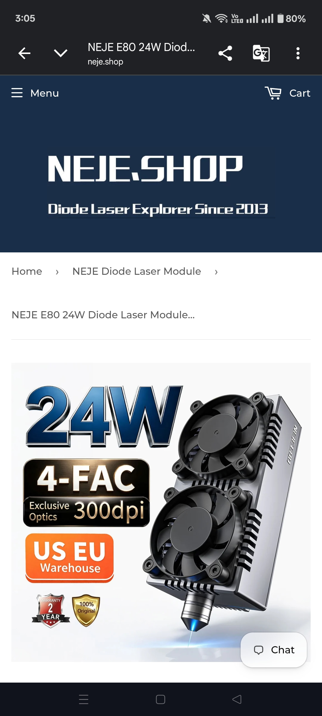

the E80 is 20w (24w, 4 diode FAC).. but is 24v, and quite heavy in comparrson to what you have…
There are couple in the 2 diode range…
NEJE Diode Laser Module – NEJE.SHOP.._gaMTc3ODAwOTExOC4xNzcxNDIxNzQ0*_ga_36PZ1XGMQ6czE3ODczMjU1OTQkbzI5JGcwJHQxNzg3MzI1NTk0JGo2MCRsMCRoMA.._ga_4K790371TB*czE3ODczMjU1OTQkbzMwJGcwJHQxNzg3MzI1NTk0JGo2MCRsMCRoMA..
  1. Is this power source will works on my machine properly?
  2. What would be the avg power (w) after integrating this?
  3. What type of materials i can engrave with this power?
  4. How many days it will take to deliver it in Bangladesh?
That is the E80..
  1. likely too heavy, and requires 24v power supply.
  2. up to 24w if done properly.
  3. same types of material you can now. with maybe the addition of marking, not engraving, stainless steel. You can blacken stainless with 10w or more, and some colour with the right stainless.
  4. No idea… NEJE may answer that..
you would be better to buy a NEJE max4 v2 than add that weight to yours
