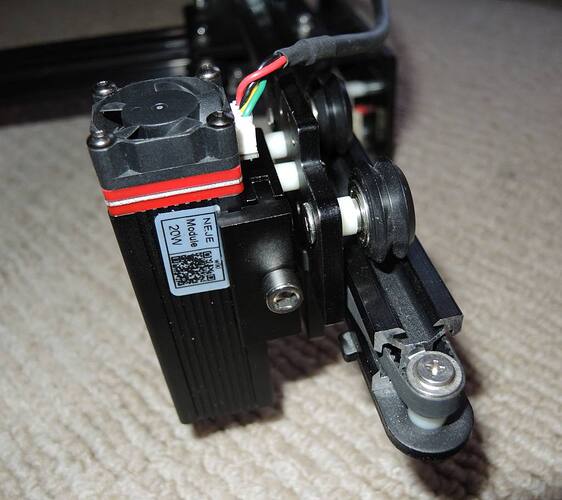

Nice, affordable but it cannot be attached to the engraver laser head holder.
Or can it?

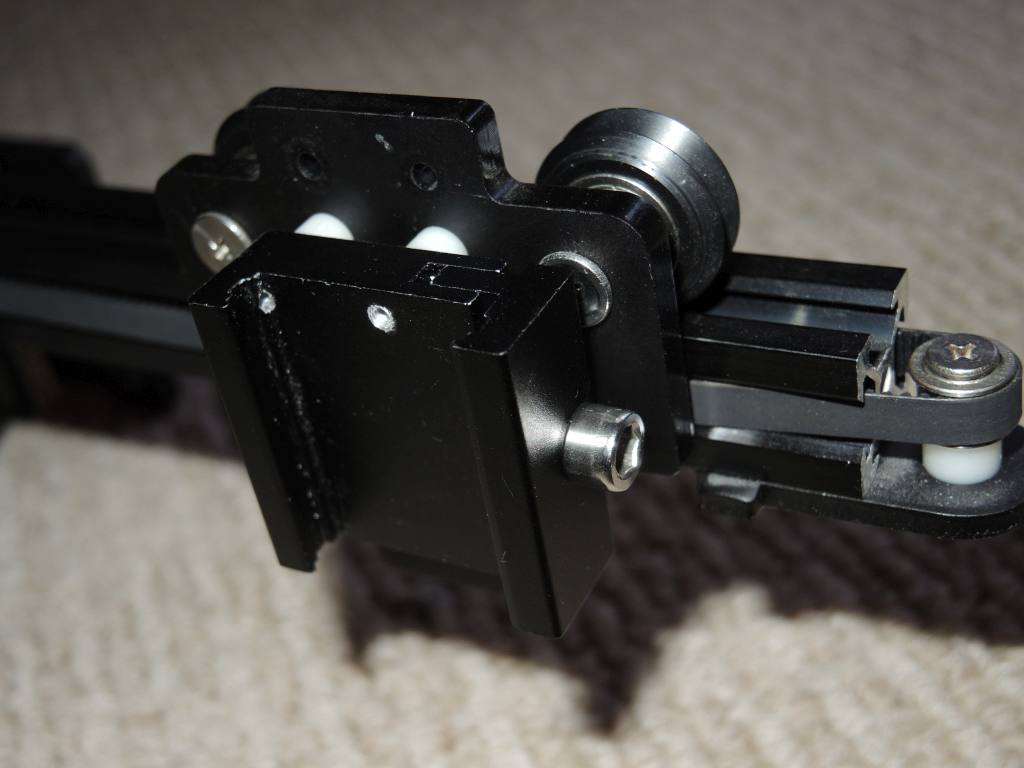

One needs to do a simple modification:
drill two holes 16.6 mm apart and tap M3.0 thread in them.
Drill the holes with 2.5 mm drill bit, then use M3.0 tap. You can use dremel-like tool for drilling.
Don’t forget to apply any lubricant when drilling and tapping.
