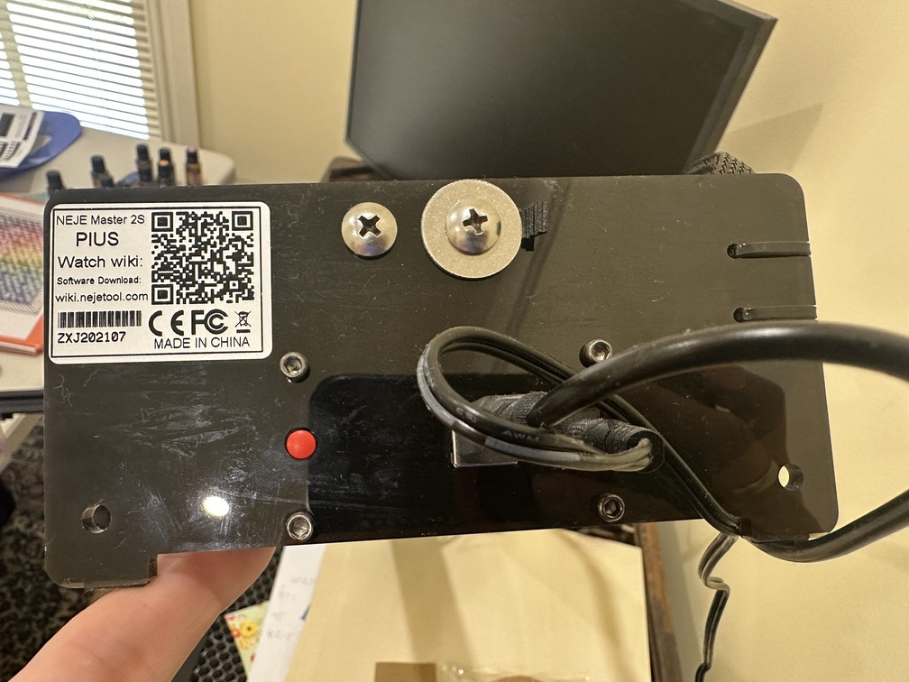

Can you send an image of your motherboard?
The 2S PLUS model is an old model without M7 M8 ports. If you need automatic control, you need to replace the new NEJE 5 PLUS motherboard.
You can look here at the features of the Neje you have.
I think the images of the motherboard are not in the previous link. Try to get someone to send them to you and I think I can advise you. I think there will be some option to be able to extract power for the relay that comes with the Neje pump, which you can see in the following link.
And here you can see the Neje bomb.
Now you don’t have connections for M7 or M8, you have to connect the pump directly to the mains a few seconds before you start cutting.
