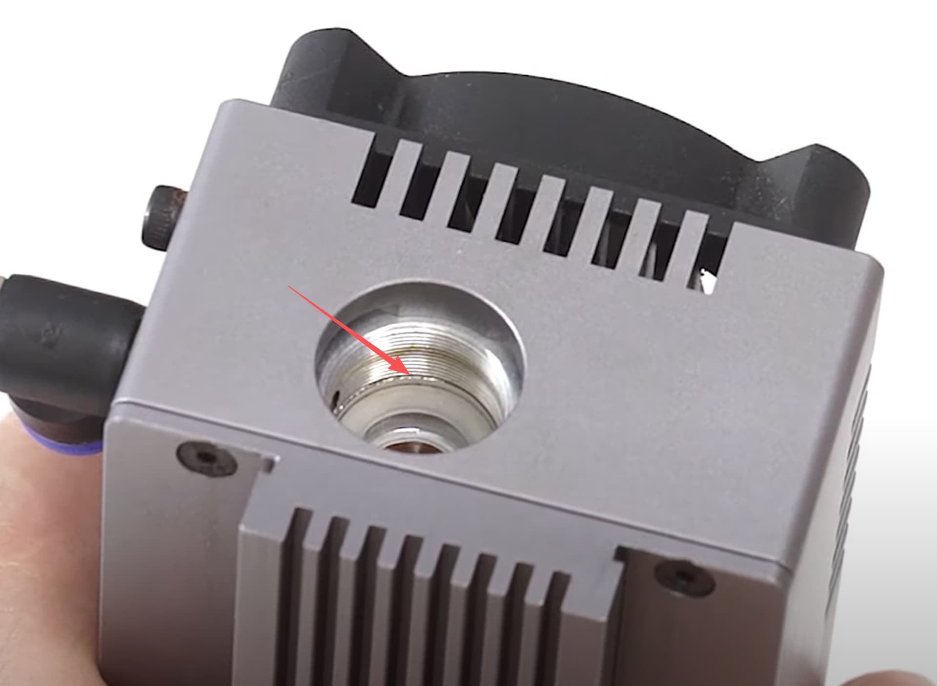

Hi customer service,
I have reeived three new lenses, but I am not able to get out the lense from the module.
I watched the video, but could not understand, what exactly is done inside - where the lense sits…
Can you please give further advise or tipps?
Best
Martin
镜头底部有一个硅胶圈,时间长了可能会粘连。您可以用尖针轻轻撬开镜头。
Hi,
thx for the tip - unfortunately in Chinese :slight_smile: - a translater told me, that I should gently pry the lens open with a sharp needle. Can you provide a video or pictures, how to do this? In the video on youtube I can not see how the lense is loosened …
Thx
Slightly pry along the edge of the lens in different directions.
