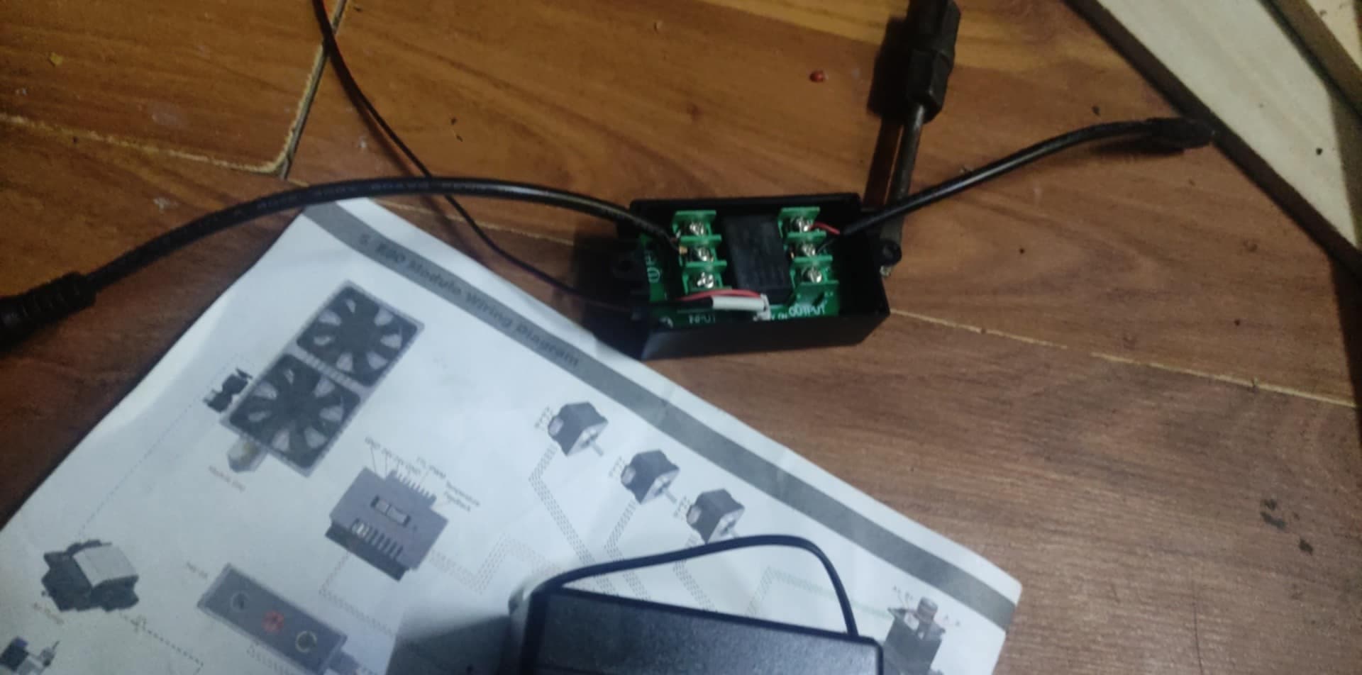

Do you know about air assist my air assist always turning on Even air using relay module. Is it that way .. Or air assist is only on when engraving or cutting.. Please tell me
Dear Sir, @JackWong
My Air assist is Working even after on relay mode on
Connection Video : https://youtube.com/shorts/Uf61s_9ouwg?feature=share
MaKing Sound : https://youtube.com/shorts/8XzLTXMFvB0?feature=share
Can you give me a video of the M7 M8 test?
When you unplug the signal input cable of the laser module, is your air compressor still on?
checking sir wait
