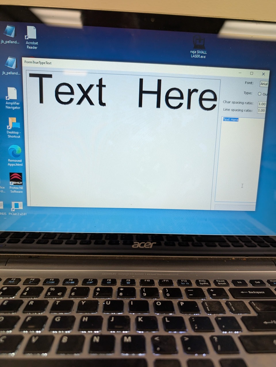

Display for adding text not visible【Fixed】
The Edit >Insert Text screen is incomplete and the right side is cut off.
No amount of adjustments or resizing changes it.
Changing Display Resolution does nothing.
The version for my ancient (2017)carver works fine on this PC. Also just noticed that there is no way to adjust laser power or speed. .
Neje 3 pro, version 6.6.9
Tried older versions, no change.
Picture attached.
This bug will fix in 3 days. please wait.
I’ll let you know here when it’s finished.
excellent thank you!
Sorry for late.
This issue is fixed at v6.7.0

Thank you Jack.
It now works correctly.
