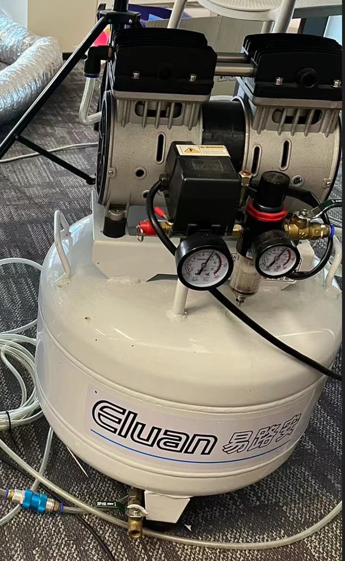

I’m using this Atom Stack compressor, but is this pump not powerful enough?
This type of air pump can only protect the lens and has little effect on improving cutting efficiency. A compressed air pump is required.
Thanks for your reply!
What kind of compressor pumps are there?
Is it possible for you to tell me?
Thank you very much. I’ll take that into consideration.
