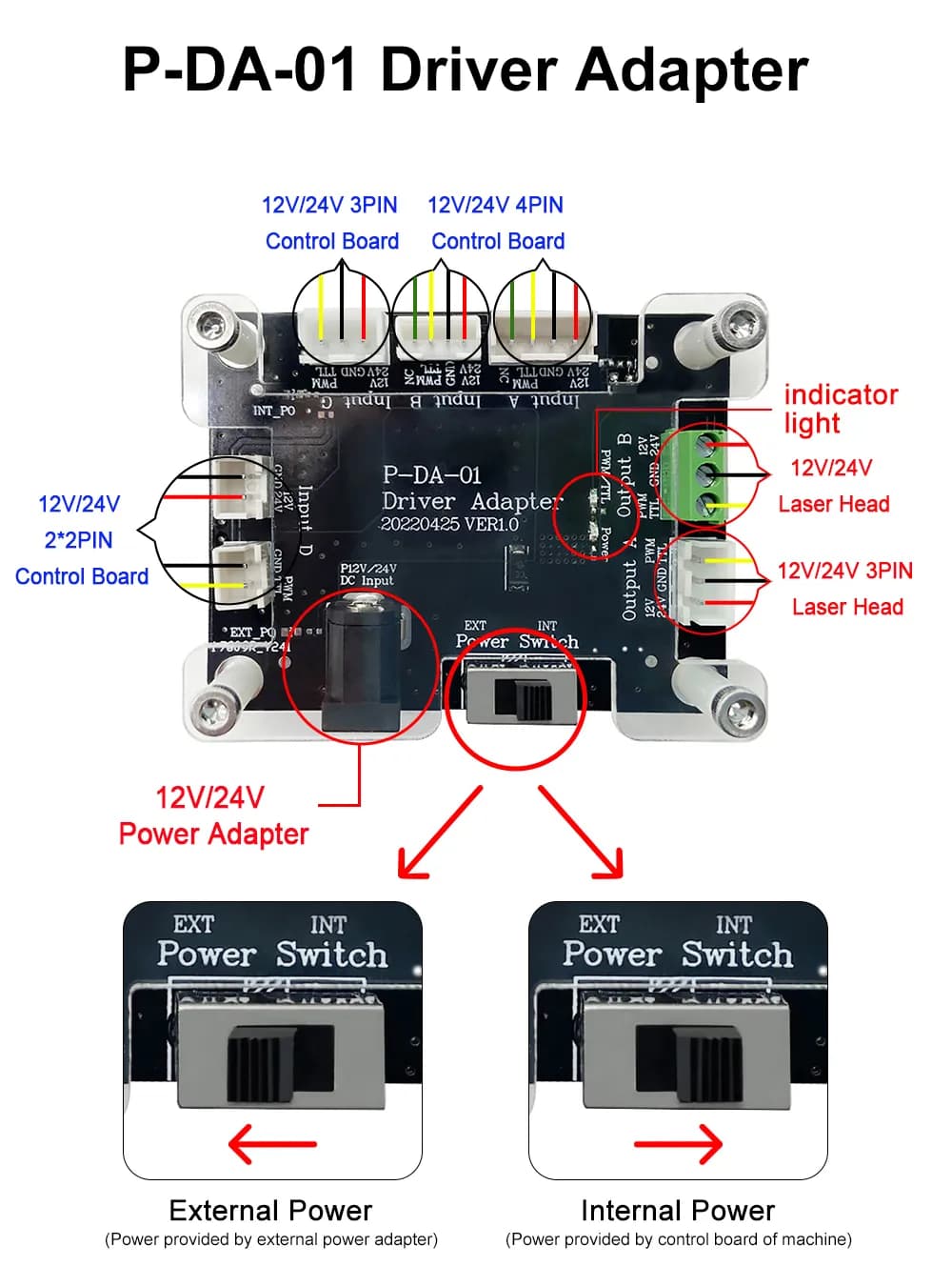

The following board is included with the laser module
*this is to clarify the question

Compatible with NEJE 3 Max (the motherboard model is higher than V1.1)

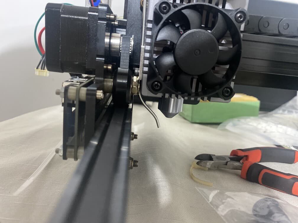

The E80 laser module is too large to touch the limit switch and requires DIY adjustment
https://forum.neje99.com/t/e80-spot-dimensions/5602/10
