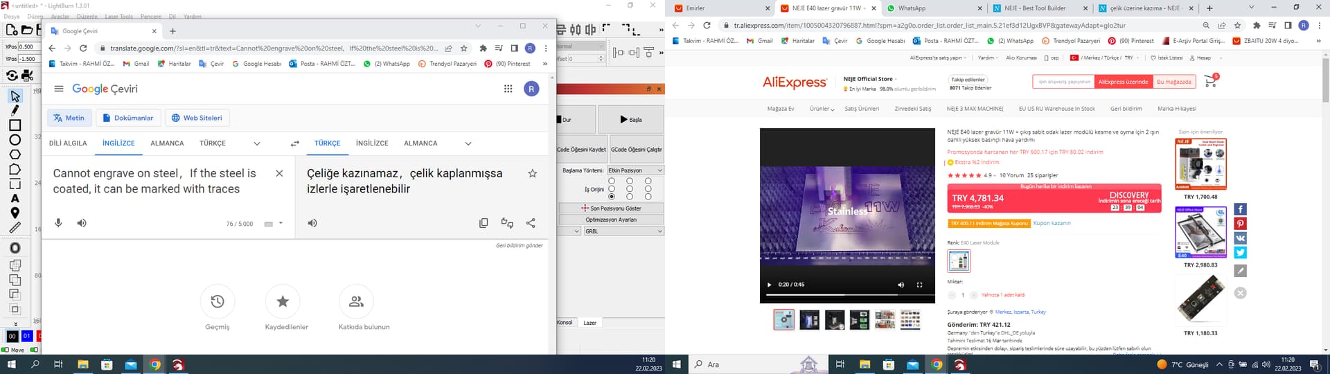

Cannot engrave on steel,If the steel is coated, it can be marked with traces
