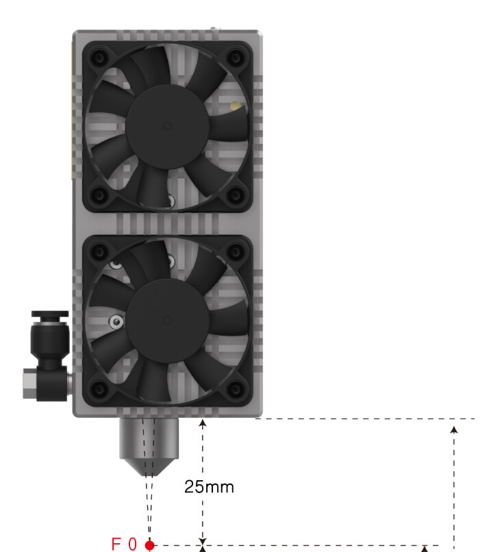

Altura que o laser E80 deve estar do projeto de trabalho
Qual a altura recomendada para que o laser trabalhe corretamente
Obrigado
It would be better to do a ramp test.
Mine came in at 22mm (instead of 25). I have noted others have done this test, and they have come in at 22 or 23mm as well.
