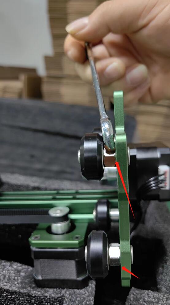

Hello. I have problems after railing on y axis.it is lagging after starting job and i do not know why.any ideas? Is there problem with leveling the machin or dust or what?
Adjust the eccentric nut at the bottom of the Y-axis; the adjustment range is 180 degrees. Loosen it as needed.
