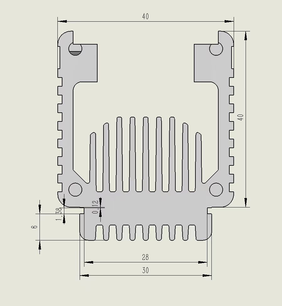

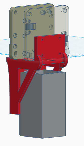

Trying to confirm the dimensions of the aluminum extrusion housing the A40640 so I can confirm measurements taken from the unit as I try to design a custom mount. I heard Jack might be able to assist. I just posted my rough design to Tinkercad with tags to make finding it easy.

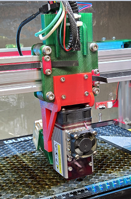

I’m considering upgrading my DIY Laser Engraver to use an E80 Laser Module but will need mounting and overall dimensions so I can adapt it to the new machine.

It has been over 3 days and I do not find the requested information detailing the dimensions of the E80 housing mounting feature. Can you please post the requested information? Something like the below from the 40640a would be most helpful.
given their lasers are interchangeable.. the dimensions on the bottom of that drawing you have will be much the same.

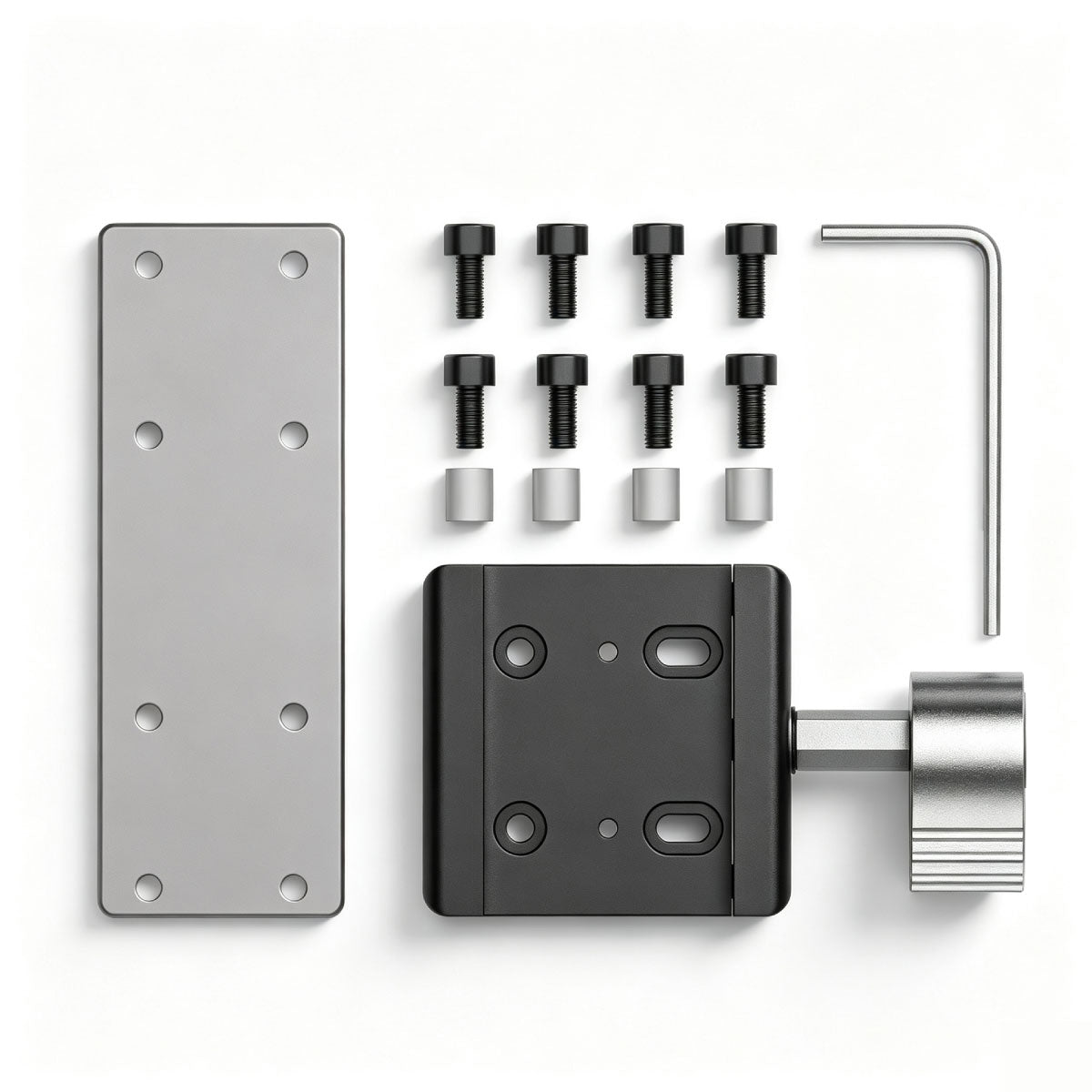

or you could incorporate their quick change mount..

This is the height adjuster for the E80 module
