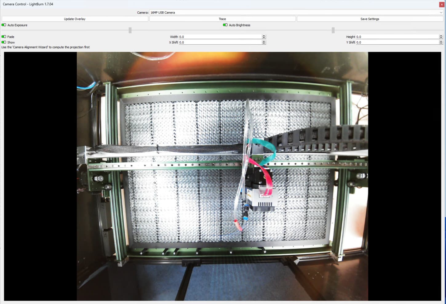

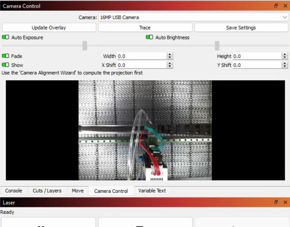

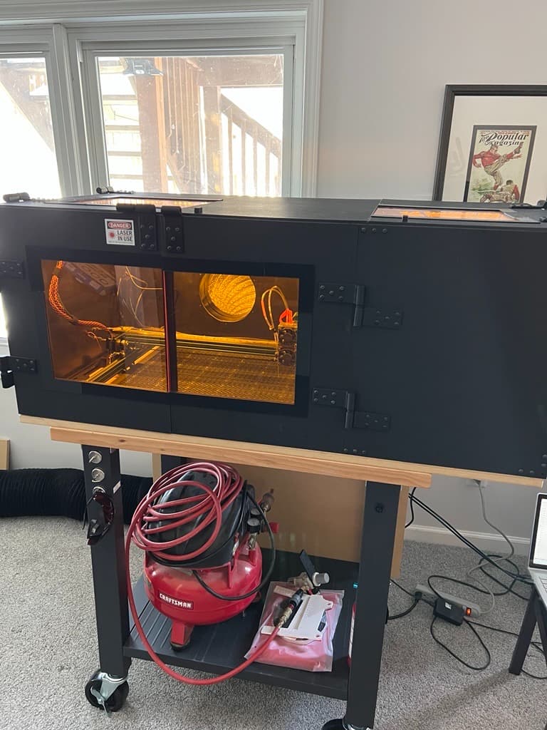

16mp (85 degree) camera not able to capture full bed 750x460 on NEJE Max 4 E80
Camera is mounted 40cm above the bed. The Neje videos show it should only need 30cm. Can this be replaced with a wider angle camera to properly view the entire bed needed for performing the lightburn camera lens alignment and calibration?

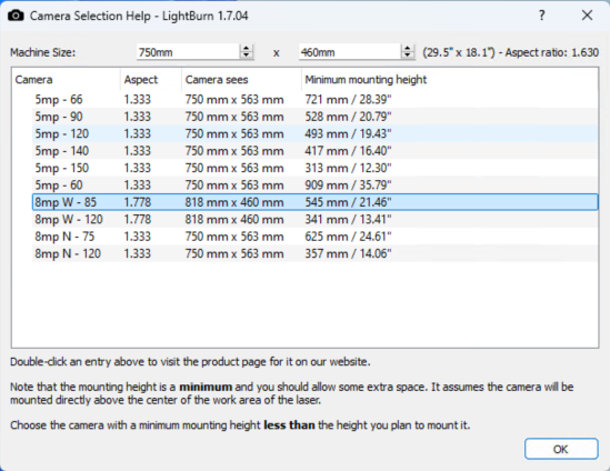

Yes, that should work. Lightburn has tables that show the relationship between focal length and distance.
https://neje.wiki/doku.php?id=camera_1
The Lightburn camera selection help isn’t specifically for the Neje 16MP camera but expect the numbers to be similar for fixed focus cameras (no manual adjustment option on the camera to adjust the focus). This proves my point that minimum height for 85 degree lens needs 5.45CM. I designed my enclosure based on the Neje documentation provided showing 30cm worked, which clearly does not work. I think Neje should replace this camera with a wider angle lens or cover the cost of a replacement based on the inaccurate documentation.

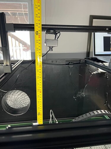

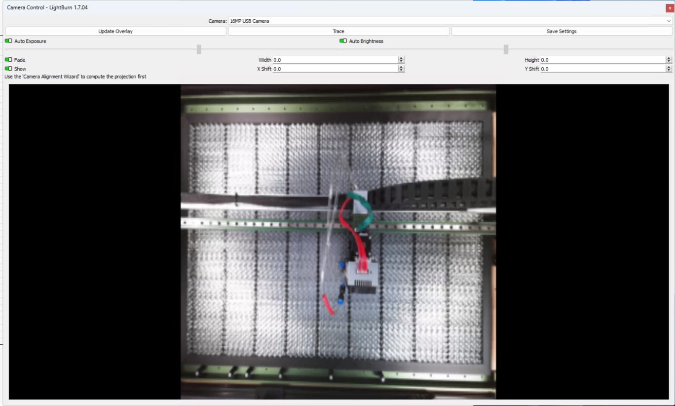

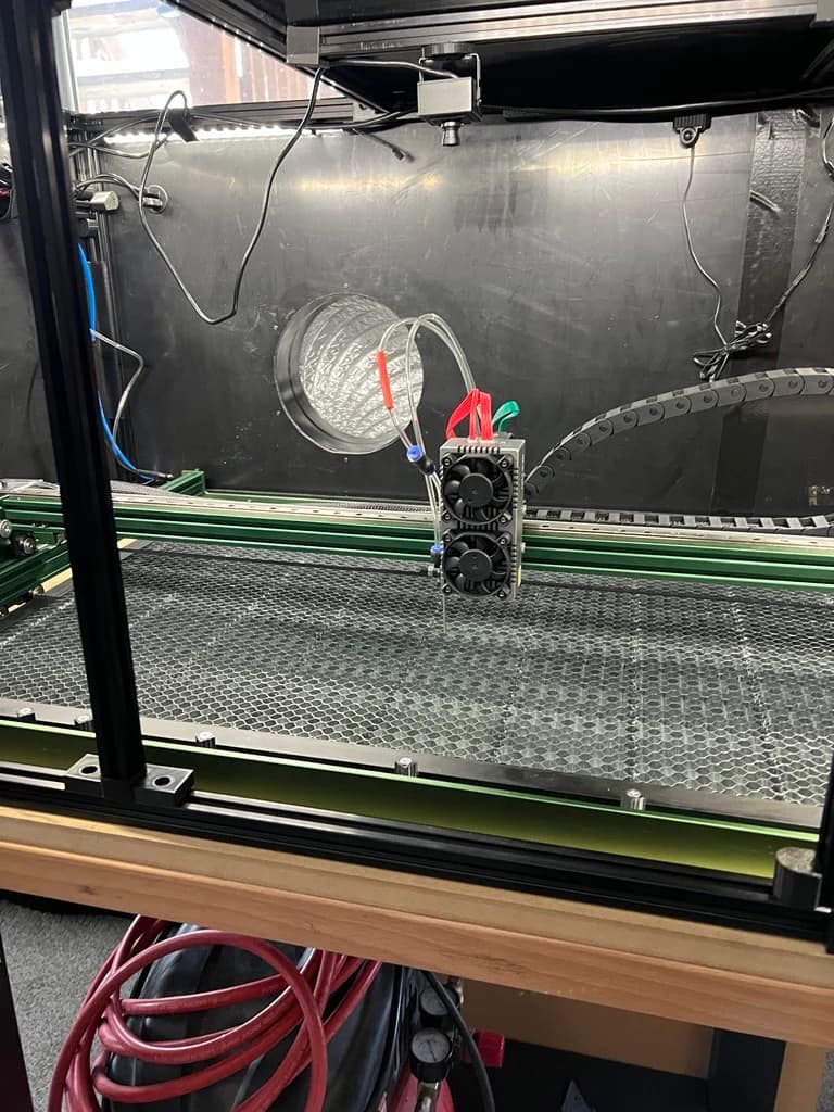

To further support my suspicions. I rigged up a temporary support to let me adjust the camera height until it was able to view the entire bed. The minimum height for this Neje 16MP (85 degree) camera is 54.5cm as you can see in the photos. As I mentioned above, my enclosure was designed based on the Neje WIKI site showing 30cm worked with this camera. It looks like my only option is a 120 degree camera for the clearance I have in my enclosure. I think Neje needs to fix their documentation and replace or refund my camera to get one that will work.
See photos for reference
